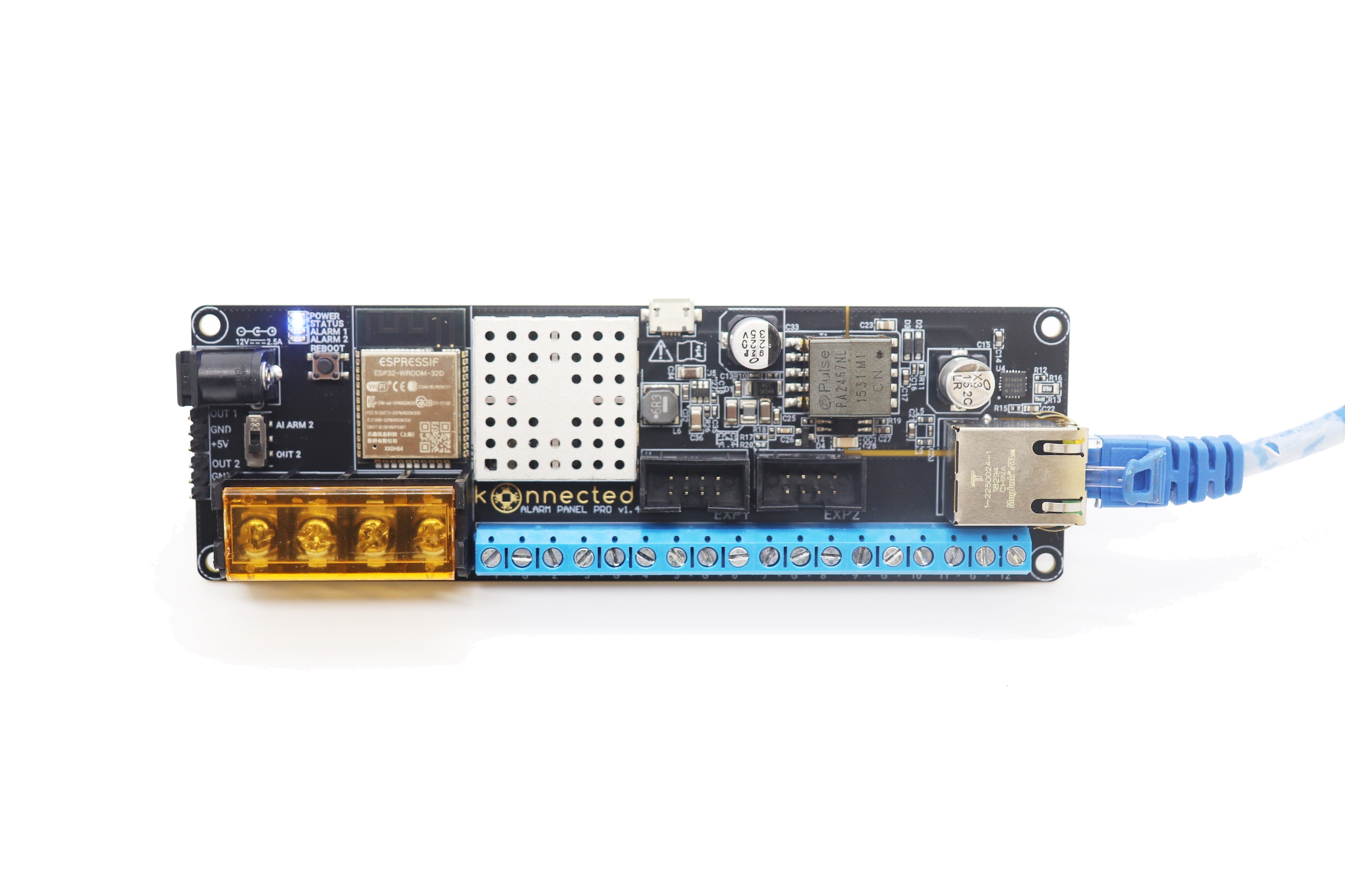

Konnected Alarm Panel Pro 1.4
The first thing you'll notice in the new design, compared to our originally published prototypes, is that it's (much!) smaller and has a square metal shield on the front.
The worst RF emissions problems were related to some components on the board that used a system clock, a harmonic pulse that helps the microcontroller components work. The problem was that this pulse was radiating off the board, creating RF noise that exceeded the FCC limits. Adding the RF shield helps keep this signal from radiating outward. Also, making the board more compact limits the distance that the pulse is traveling through the board, making it easier to contain.
Comparing an earlier version of the Alarm Panel Pro, the hotspot of radiated emissions at 50MHz is greatly reduced!
