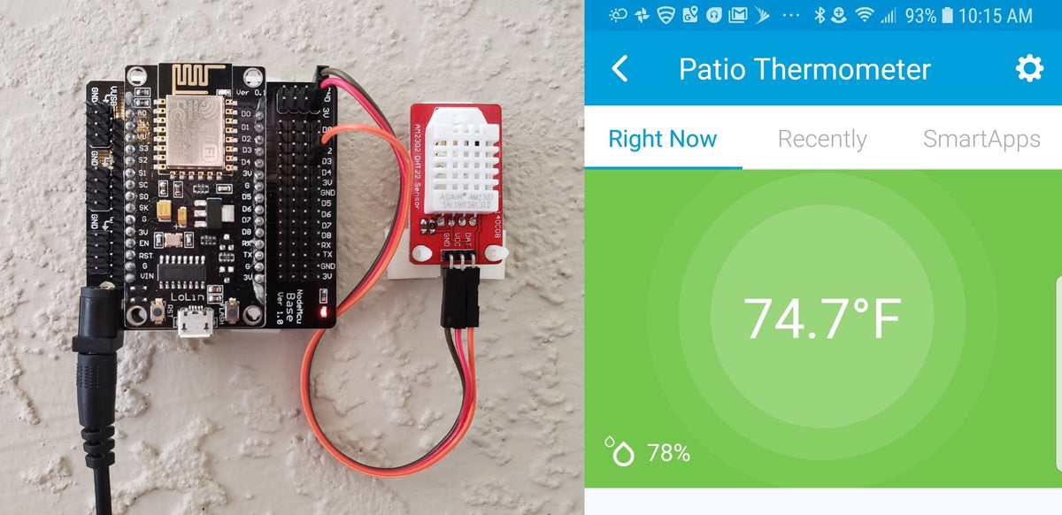

- New! Support for digital temperature and humidity sensor modules. Now you can monitor the ambient temperature with Konnected and SmartThings* and an inexpensive DHT22 module. Buy one here for only $9.50.

Can you connect a Temperature & Humidity sensor to the Konnected Security panel? If so how do you connect it?
The new firmware seems to be running ok on my DIY boards. I don’t have much experience with the previous version. I just connected a temp-humidity sensor and it picked right up after resetting the module. That is a nice feature and I appreciate you building it.

The temp/humidity sensor handling is a great addition! I plan to use it to monitor the refrigerators and the freezer we have in the garage.Thanks for a great product!
